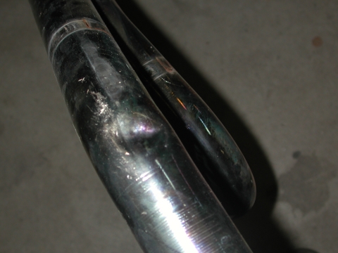

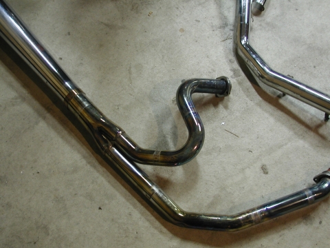

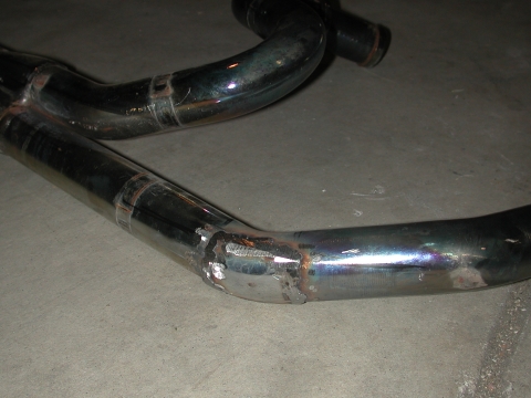

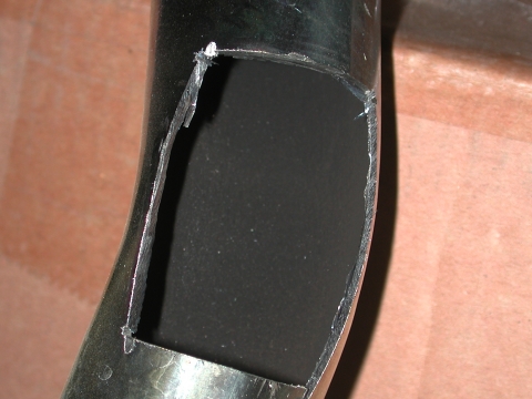

now the fun...... i got my bike w/ a set of twin exahsut, non muffled, and it .... was A. super fucking loud, B. didnt fit for shit. so i asked around and found a kice kerker ehxaust tha thad been in a axident and bout to be scrapped. i took the exhast i had, cut off its mounts, cut off the kerker mounts, cut up some scrap tube, and fixed the kerker exhaust.  if u look at the #1 (lowes in the pic) exhasut runner it has a big dent at the bend where it starts going to the back of the bike.
check out this lill gem......... notice how hot the exhasut got due to the fucked up flow of the dent..
no more dent part 1.
no more dent part 2.
its not perfact, cuz it didnt need to be, it flows well and thats what i was after.... stupied guys said "its a all stainless system" yeah.. thats 100% magnetic AKA regural old steel.... fucktards.....

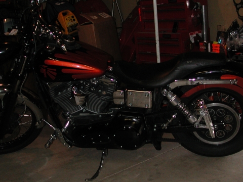

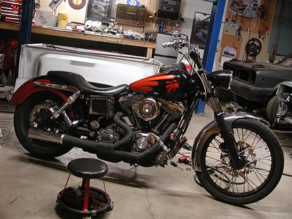

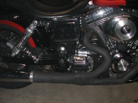

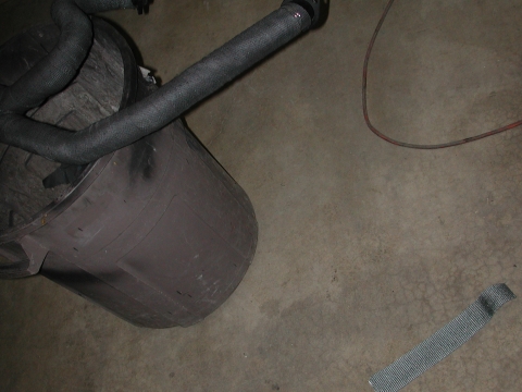

after i found out this shit was just steel exhaust i decided to do this. i installed 49' of exhaust wrap.
and here it is all finished and installed. i made a nice brushed alum retainer strap for the end of the wrap.

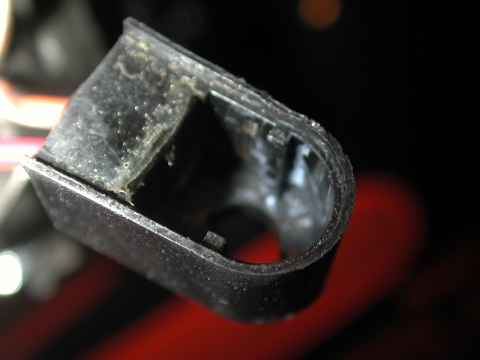

i have had issues w/ my front break lever causing the break light to do stupid shit and such. tellme if u notice something wong with my rear break light switch.
yeah its guts are missing..... fucking thing was in pieces inside my swithc housing just randomly shorting out at will. so i cu tit off and properly capped the wires. now i only have  a break light that works with my rear wheel break, but at least it isnt flickering and ackting insaine 99% the time.

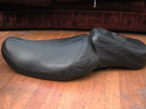

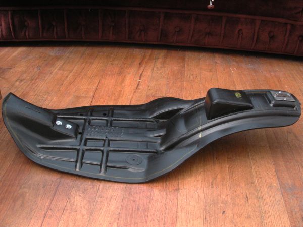

and this weekes progress.......
i took a spare seat iv never used and started making some changes to it....
after stirpping it down i ended up witha ncie seat pan to start my new seat with

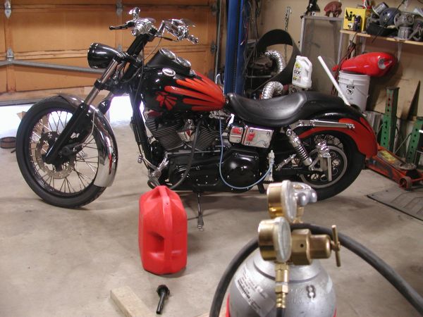

and no, im not all sad i dont have my old fj to rdrive around w/ a gas can with any more..... im just draining the fuel tank

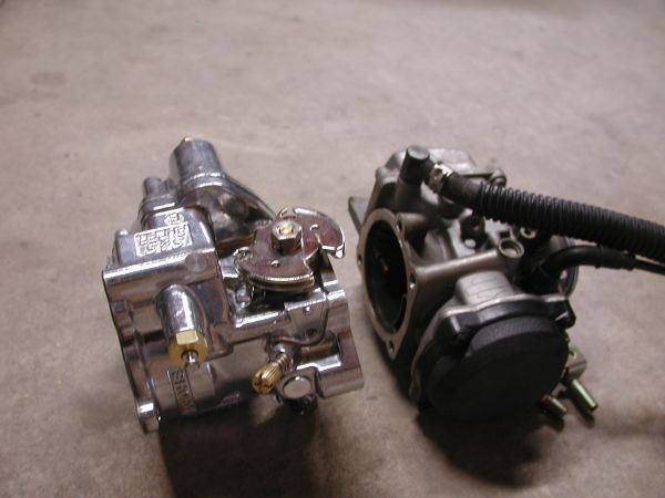

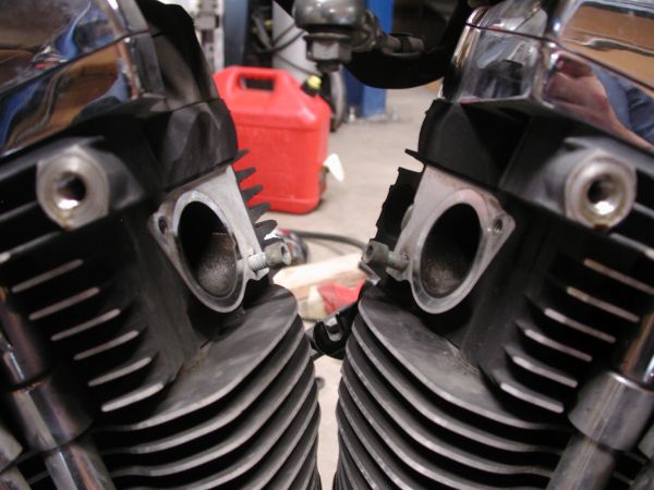

one unfun place to get a alen wrench and trun tigh as fhell bolts

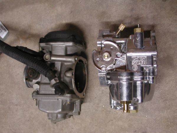

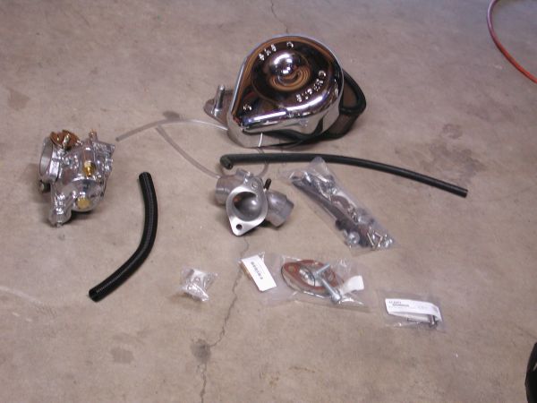

new S&S super E carb next to stock HD carb
and the tops of the carbs, notice how the S&S carb actuly has adjustments that u cna freaking get to!..
sure dosnt seem like many parts for what they charge for all this bs..
and done..... so far i realy dig it, i havnt done anythign but set the idle and rive the hell out of it and wow its so much better
