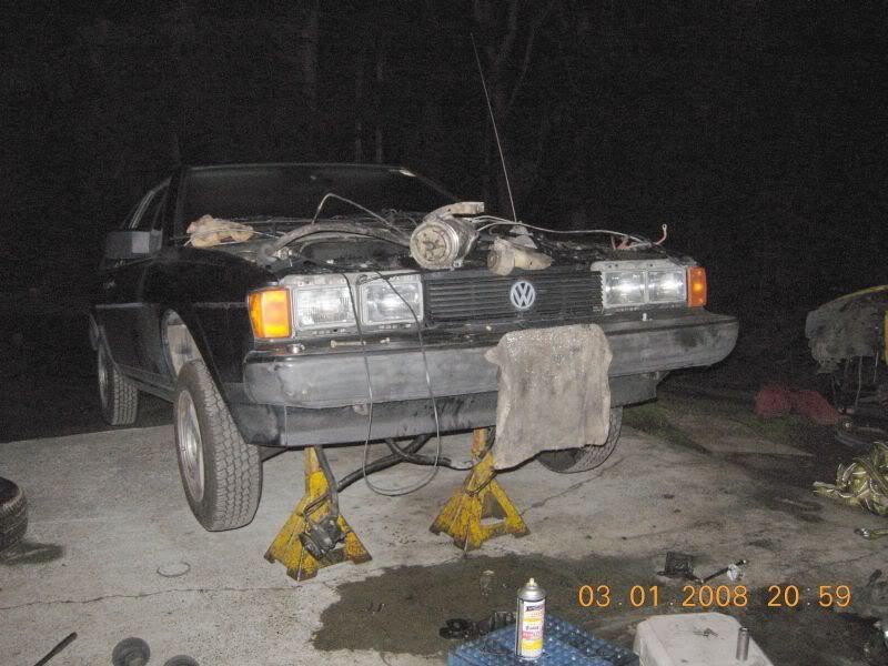

Replacing the engine in my 85.

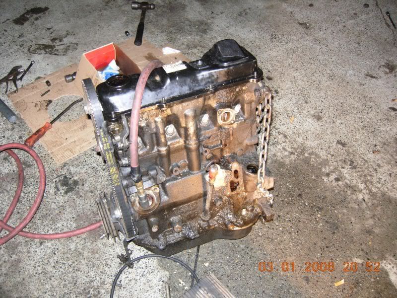

The old engine. Notice that the front is entirely coated in burnt oil. That's all fresh. Maybe three weeks old. JH motor.
I had forgotten what a pain in the ass it is to get the motor out of a Rocco with the trans still attached.

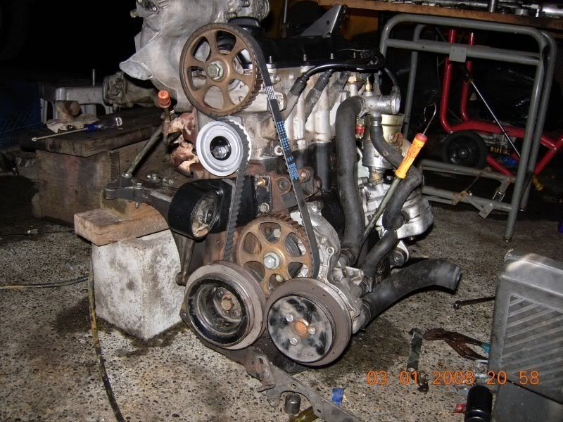

The GX (low compression ratio. It's like 9/1) with my bigger intake, throttle body and oil cooler slapped on it.
Head's been yanked, serviced and replaced.

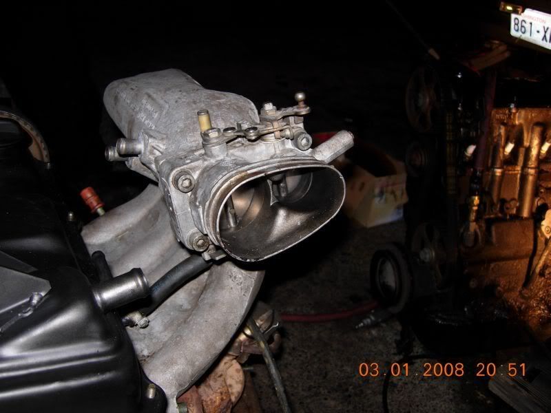

20 years of fine particulate built up in the big-bore throttle body.
I'd clean it but it's so fine and well bonded that I think it would do more harm than good.

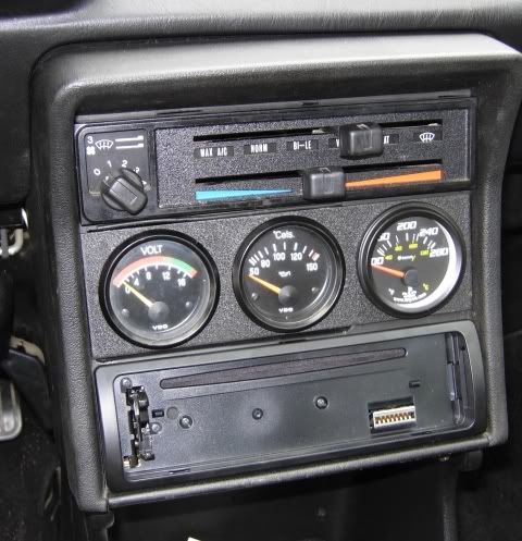

Ten minutes work with a dremel. The temp guage on the dash always displayed random bullshit, so I just added one over my stereo.
