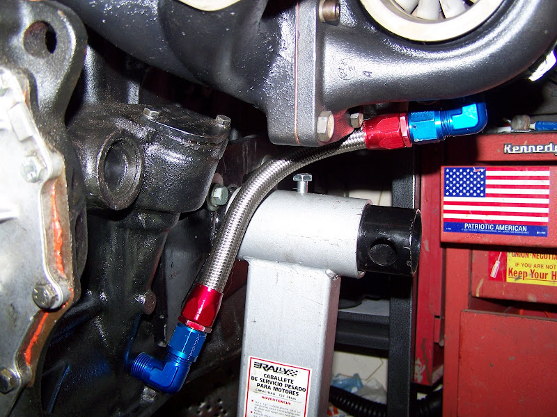

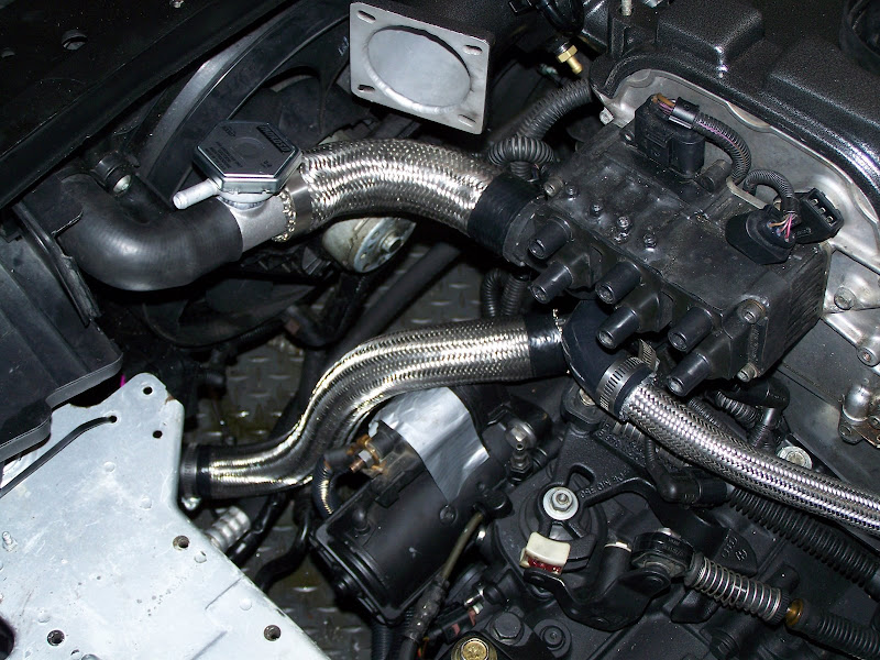

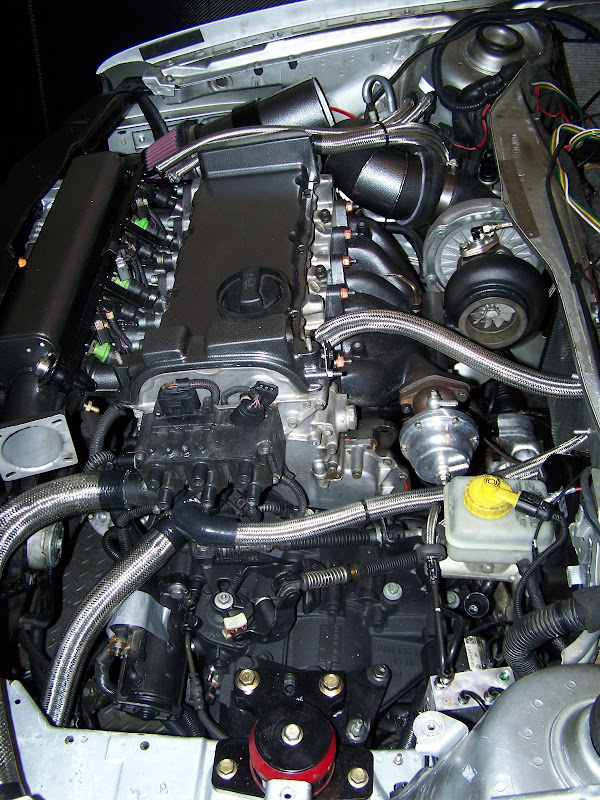

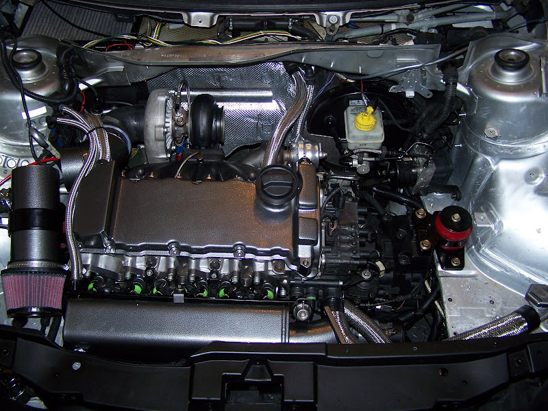

Got the oil return done, and the motor back in..
Posts: 1493
Re: 3.0L VR6T
« Reply #50 on: April 07, 2008, 07:47:48 AM »
did  u paint or powder coat or use ur self ceramic coat stuff for the tranny case? its looking mean man!......... bout ready for some duct work/exuast loving?!1.........

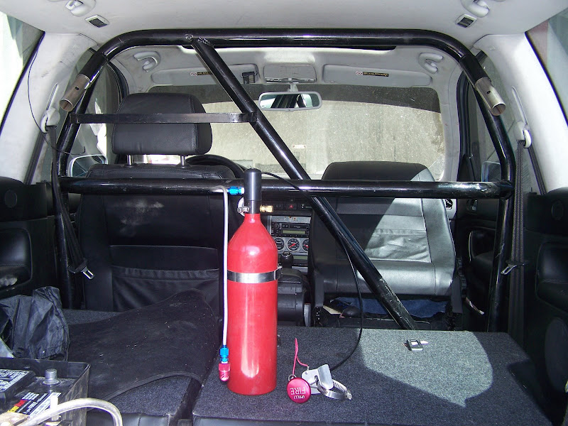

yea but its Halon 1211, not how sure I want that going off in-cab.. guess suffocating does beat being burned alive.  Thinking of plumbing it through the firewall into the engine bay where it could possibly prove usefull and not deadly. It came with all the mounting hardware to mount it to the roll bar behind my seat. It would have to be removed for racing tho, Halon 1211 is not allowed for sanctioned racing anymore.
this roll cage was out of a B5 S4 so the support beams are gona need yer attention, you back in town yet? I am waiting on my BOV but we can drag this to yer place whenever is the best time for ya.

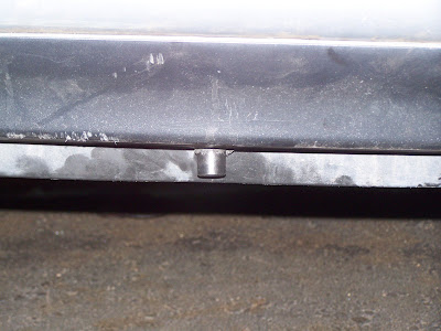

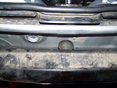

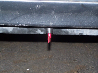

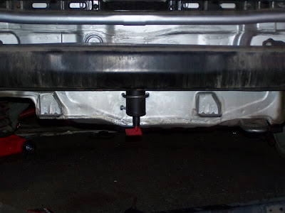

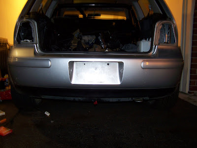

I mounted my stock golf front and rear valences today, mounted up my external kill switch.. this is required for me to pass tech inspection at any race course because I have my battery re-located. It wont be functional and will have the key removed while I am in street mode but with a flip of a switch and all my power will be routed through this switch... allowing them to kill the power/motor easy if anything bad should happen.
Needs to be wired still obviously, If you look you can see a grommet a few inches to the left where my tube comes up behind the bumper.. that'll be where I run the wires through to the inside.
Encase anyone else re-locates there battery and still wants to take it to the drag strip this was STUPID easy, just took a few bong hits to figure it all out :P
no more visible exhaust tip either   cheers
