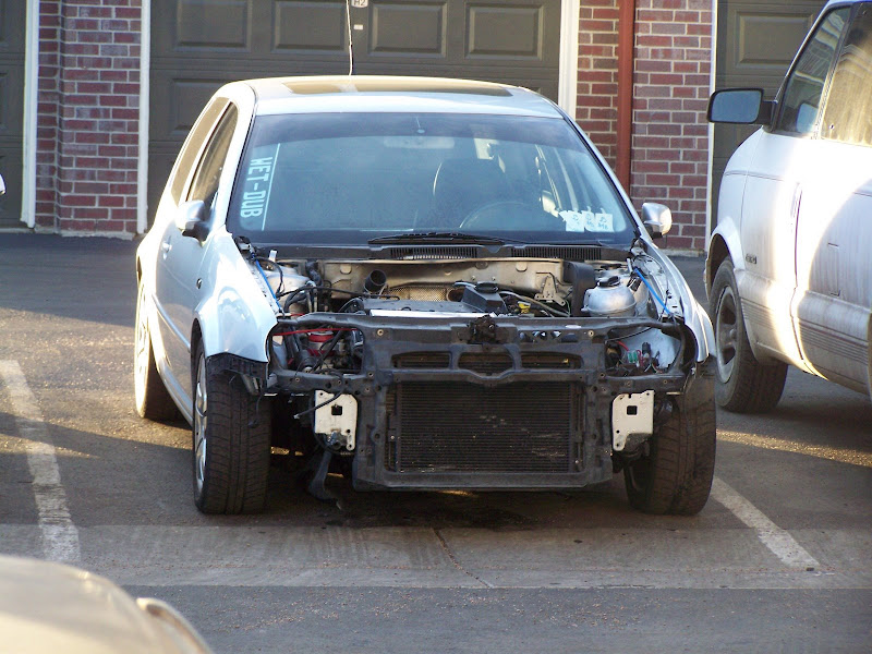

Hopefully my buddy will come through this weekend with his hoist (he had a really bad last weekend) and I'll get the existing motor ripped out..
Here's a picture of it last weekend, I had planed on ripping out the motor but that wasent happening so I pushed it outside and we installed those vmaxx coilovers..
I droped my air intake off at my powder coater's place, he is going to two tone it as a sample and once I approve of the color scheme I'll be taking my intake manifold, boost pipes, motor mounts, tranny case and couple other things in to get a nice fresh coating.
